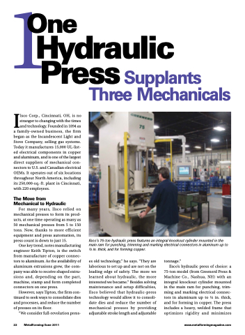

Ilsco’s 75-ton hydraulic press features an integral knockout cylinder mounted in the main ram for punching, trimming and marking electrical connectors in aluminum up to 1⁄2 in. thick, and for forming copper.
