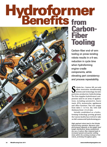

Hydroformer Benefits
Carbon-fiber end-of-arm tooling on press-tending robots results in a 6-sec. reduction in cycle time when hydroforming engine-cradle components, while elevating part consistency and process repeatability.
Schuler Inc., Canton, MI, not only offers innovative metalforming systems and technology, but also performs production hydroforming. The firm supplies hydroformed com- ponents used in an array of applica- tions, including automotive, heavy truck, ATVs, motorcycles, appliances and office furniture. Part size ranges from tubes 1- to 6-in. dia. with wall thickness from 1.4 to 8 mm.
Initially established as a hydro- forming-technology proving ground, the Canton facility has evolved to take on full commercial hydroforming pro-
High-payload robots tend to the Schuler hydroforming operation. Because robot performance depends on the weight (and weight distribution) being cantilevered, the use of carbon-fiber material leads to increased speeds and quicker settling times within the working envelope of the robots, promising throughput gains.
from Carbon- Fiber Tooling
