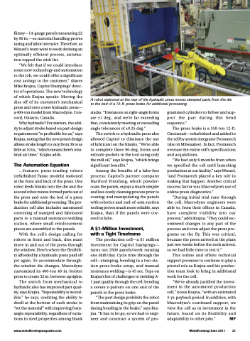

...features press-tending robots (refurbished Fanuc models) stationed at the front and back of the press. One robot feeds blanks into the die and the second robot moves formed parts out of the press and onto the bed of a press brake for additional processing. The pro- duction cell also includes automated conveying of stamped and fabricated parts to a manual resistance-welding station, where small reinforcement pieces are assembled to the panels.
With the cell’s design calling for robots in front and back, dies must move in and out of the press through the window. Here’s where the flexibili- ty afforded by a hydraulic press paid off yet again. To accommodate through- the-window die changes, Macrodyne customized its 400-ton 48-in.-bolster press to create 52 in. between uprights.
The switch from mechanical to hydraulic also has improved part qual- ity, says Krajna. “Repeatability is incred- ible,” he says, crediting the ability to dwell at the bottom of each stroke to “set the material” with improving form- angle repeatability, regardless of varia- tions in steel properties among blank
A robot stationed at the rear of the hydraulic press moves stamped parts from the die to the bed of a 12-ft. press brake for additional processing.
