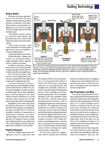

Fig. 3—Once the misfeed spring force equals the tap’s required axial engagement force, the tap bites into the part (right) and tapping begins, albeit late. As a result, valuable rotational movement required for tapping has been expended, resulting in an incompletely tapped thread. The left image illustrates the tap’s approach, while the center image illustrates suc- cessful tap penetration.
Tooling Technology
 Square or splined drive shaft
Misfeed spring should remain static during entire tapping cycle
Misfeed spring deflects during tapping cycle
Male lead bushing
Male and female lead bushings, have same pitch as the tap and cause the tap to advance toward the part as rotation occurs
Approach
All lead-in threads
travel completely thru part
Successful tap penetration
Tap skid
Misfeed spring
Female lead bushing
Required axial force for tap engagement exceeds available preload in misfeed spring

One of the requirements for achiev- ing a quality thread is driving the tap to its proper depth within the workpiece. Typical nonbottoming taps for IDT will have 2.5 to 5 lead-in threads, and to achieve a complete thread, the tap must drive through the workpiece beyond all of its lead-in threads. If the tap is set too far from the workpiece, it will likely fall short of successfully pen- etrating the part by the end of the tap- ping stroke. And, if the tap is set too close to the workpiece, another set of problems (which are beyond the scope of this article) can occur.
Aside from incorrect tap-setup posi- tion, there’s another scenario that also can result in the tap failing to fully pen- etrate the workpiece—tap wear. The
MetalForming/April 2011 41
