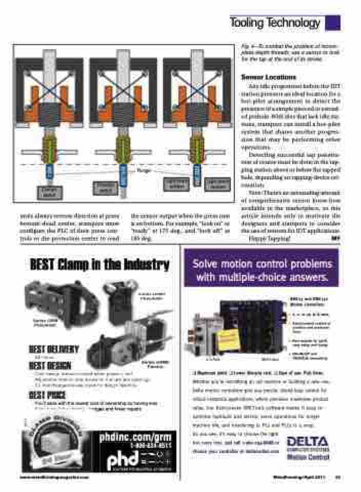

units always reverse direction at press bottom-dead center, stampers must configure the PLC of their press con- trols or die-protection center to read
the sensor output when the press ram is on bottom. For example, “look on” or “ready” at 175 deg., and “look off” at 185 deg.

Fig. 4—To combat the problem of incom- plete-depth threads, use a sensor to look for the tap at the end of its stroke.
Sensor Locations
Any idle progression before the IDT station presents an ideal location for a hot-pilot arrangement to detect the presence of a simple pierced or extrud- ed prehole. With dies that lack idle sta- tions, stampers can install a hot-pilot system that shares another progres- sion that may be performing other operations.
Detecting successful tap penetra- tion of course must be done in the tap- ping station above or below the tapped hole, depending on tapping-device ori- entation.
Note: There’s an astounding amount of comprehensive sensor know-how available in the marketplace, so this article intends only to motivate die designers and stampers to consider the use of sensors for IDT applications.
