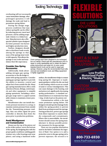

   Some springs have been designed to be recharged, but not rebuilt. Check with the manufacturer prior to repair to verify repairability and to obtain the appro- priate instructions and repair kit. In some cases, standard bench tools can be used to repair gas springs. However, using the recommended load cells, removal and installation tools, and filling equipment is highly suggested.
