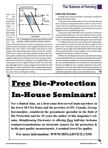

with a coil
of the
intended
production
steel (mid-
range n-
value),
most of the
parts exhib-
ited necks
or tears—a
major prob-
lem. The
vendor that
fault because the purchase order simply specified the use of AKDQ steel. The vendor used AKDQ steel from its stock supply, and it made all good parts. When tested, the vendor’s steel had an n-value in the upper 20th percentile of the nor- mal property distribution provided by the steel mill. The steel supplier argued that it had given an honest property distri- bution and could not be required to only supply AKDQ steel with properties in the upper 20th percentile. The steel sup- plier did suggest that a vacuum-degassed interstitial-free steel with higher n-values would better fit the engineering window. However, the press shop did not want to pay the extra cost for the steel or for reworking the tooling.
Fail n
Mill Capability
Yield Strength
Fig. 3—Overlaying the engineering window and mill capability reveals potential production problems.
built and tried out the tool argued it was not his
