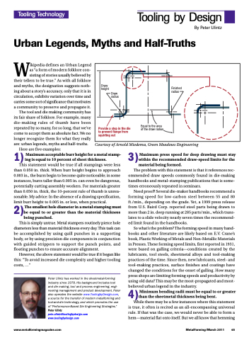

                            Draw height
Draw radius
Provide a step in the die to prevent flange from squirting out
Finished radius
                                                  Equal to the area of the draw radius
 Courtesy of Arnold Miedema, Green Meadows Engineering
