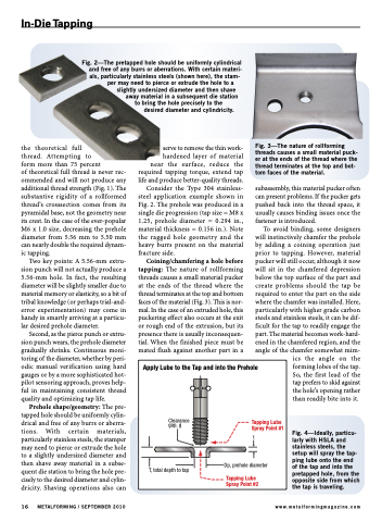

    Fig. 3—The nature of rollforming threads causes a small material puck- er at the ends of the thread where the thread terminates at the top and bot- tom faces of the material.

Prehole shape/geometry: The pre- tapped hole should be uniformly cylin- drical and free of any burrs or aberra- tions. With certain materials, particularly stainless steels, the stamper may need to pierce or extrude the hole to a slightly undersized diameter and then shave away material in a subse- quent die station to bring the hole pre- cisely to the desired diameter and cylin- dricity. Shaving operations also can

Fig. 2—The pretapped hole should be uniformly cylindrical and free of any burrs or aberrations. With certain materi- als, particularly stainless steels (shown here), the stam-
away material in a subsequent die station to bring the hole precisely to the
desired diameter and cylindricity.
serve to remove the thin work-
hardened layer of material near the surface, reduce the required tapping torque, extend tap life and produce better-quality threads. Consider the Type 304 stainless- steel application example shown in Fig. 2. The prehole was produced in a single die progression (tap size = M8 x 1.25, prehole diameter = 0.294 in., material thickness = 0.156 in.). Note the ragged hole geometry and the heavy burrs present on the material
fracture side.
Coining/chamfering a hole before tapping: The nature of rollforming threads causes a small material pucker at the ends of the thread where the thread terminates at the top and bottom faces of the material (Fig. 3). This is nor- mal. In the case of an extruded hole, this puckering effect also occurs at the exit or rough end of the extrusion, but its presence there is usually inconsequen- tial. When the finished piece must be mated flush against another part in a
subassembly, this material pucker often can present problems. If the pucker gets pushed back into the thread space, it usually causes binding issues once the fastener is introduced.
To avoid binding, some designers will instinctively chamfer the prehole by adding a coining operation just prior to tapping. However, material pucker will still occur, although it now will sit in the chamfered depression below the top surface of the part and create problems should the tap be required to enter the part on the side where the chamfer was installed. Here, particularly with higher grade carbon steels and stainless steels, it can be dif- ficult for the tap to readily engage the part. The material becomes work-hard- ened in the chamfered region, and the angle of the chamfer somewhat mim-
ics the angle on the forming lobes of the tap. So, the first lead of the tap prefers to skid against the hole’s opening rather than readily bite into it.
Fig. 4—Ideally, particu- larly with HSLA and stainless steels, the setup will spray the tap- ping lube onto the end of the tap and into the pretapped hole, from the opposite side from which the tap is traveling.
