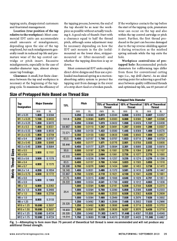

Workpiece control/size of pre- tapped hole: Recommended prehole diameters for rollforming taps differ from those for conventional cutting taps (i.e., tap drill charts). As an ideal starting point for achieving a good bal- ance between quality rollformed threads and optimized tap life, use 65 percent of
Size of Pretapped Hole Based on Thread Size
       Tap Designation
Major Diameter
   T.P.I.
Pitch
Pretapped Hole Diameter
 75% of Theoretical Thread
65% of Theoretical Thread
55% of Theoretical Thread

                                                                                                              Fig. 1—Attempting to form more than 75 percent of theoretical full thread is never recommended and will not produce any additional thread strength.
