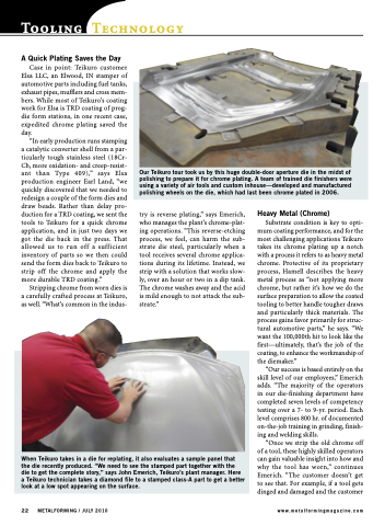

 Our Teikuro tour took us by this huge double-door aperture die in the midst of polishing to prepare it for chrome plating. A team of trained die finishers were using a variety of air tools and custom inhouse—developed and manufactured polishing wheels on the die, which had last been chrome plated in 2006.
  When Teikuro takes in a die for replating, it also evaluates a sample panel that the die recently produced. “We need to see the stamped part together with the
die to get the complete story,” says John Emerich, Teikuro’s plant manager. Here a Teikuro technician takes a diamond file to a stamped class-A part to get a better look at a low spot appearing on the surface.
