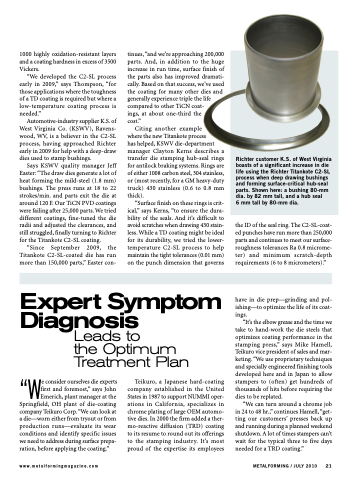

  Richter customer K.S. of West Virginia boasts of a significant increase in die life using the Richter Titankote C2-SL process when deep drawing bushings and forming surface-critical hub-seal parts. Shown here: a bushing 80-mm dia. by 82 mm tall, and a hub seal
6 mm tall by 80-mm dia.

“We developed the C2-SL process early in 2009,” says Thompson, “for those applications where the toughness of a TD coating is required but where a low-temperature coating process is needed.”
Automotive-industry supplier K.S. of West Virginia Co. (KSWV), Ravens- wood, WV, is a believer in the C2-SL process, having approached Richter early in 2009 for help with a deep-draw dies used to stamp bushings.
Says KSWV quality manager Jeff Easter: “The draw dies generate a lot of heat forming the mild-steel (1.8 mm) bushings. The press runs at 18 to 22 strokes/min. and parts exit the die at around 120 F. Our TiCN PVD coatings were failing after 25,000 parts. We tried different coatings, fine-tuned the die radii and adjusted the clearances, and still struggled, finally turning to Richter for the Titankote C2-SL coating.
“Since September 2009, the Titankote C2-SL-coated die has run more than 150,000 parts,” Easter con-
tinues, “and we’re approaching 200,000 parts. And, in addition to the huge increase in run time, surface finish of the parts also has improved dramati- cally. Based on that success, we’ve used the coating for many other dies and generally experience triple the life compared to other TiCN coat-
ings, at about one-third the cost.”
Citing another example
where the new Titankote process
has helped, KSWV die-department manager Clayton Kerns describes a transfer die stamping hub-seal rings for antilock braking systems. Rings are of either 1008 carbon steel, 304 stainless, or (most recently, for a GM heavy-duty truck) 430 stainless (0.6 to 0.8 mm thick).
“Surface finish on these rings is crit- ical,” says Kerns, “to ensure the dura- bility of the seals. And it’s difficult to avoid scratches when drawing 430 stain- less. While a TD coating might be ideal for its durability, we tried the lower- temperature C2-SL process to help maintain the tight tolerances (0.01 mm) on the punch dimension that governs
the ID of the seal ring. The C2-SL-coat- ed punches have run more than 250,000 parts and continues to meet our surface- roughness tolerances Ra 0.8 microme- ter) and minimum scratch-depth requirements (6 to 8 micrometers).”
