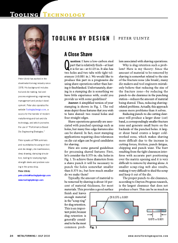

Question: I have a low-carbon steel part that is relatively thick—at least it is for us—at 0.125 in. It also has two holes and two tabs with tight tol- erances (±0.001 in.). We would like to produce this part in a progressive die using shave operations rather than hav- ing it fineblanked. Unfortunately, shav- ing in a stamping die is something we have little experience with; could you provide us with some guidelines?
Answer: A simplified version of your stamping is shown in Fig. 1. The red areas depict those features that you wish to have shaved: two round holes and four straight edges.
Shave operations generally are asso- ciated with punched openings such as holes, but many free-edge features also can be shaved. In fact, most stamping applications requiring close tolerances on die-cut edges can be good candidates for shaving.
Here are some general guidelines for processing shaved features: First, let’s consider the 0.375-in.-dia. holes in Fig. 1. To achieve these diameters from a shave punch it will be necessary to punch the holes somewhat smaller than 0.375 in.; but how much smaller do we make them?
Typically, the amount of material to be removed by shaving is about 10 per- cent of material thickness, for most materials. This provides a good surface finish and leaves
enough material
in the “scrap ring”
for slug retention.
This is an impor-
tant point, because
slug retention is
generally consid-
ered to be the most
common prob-
  2X 0.375 ± 0.001
