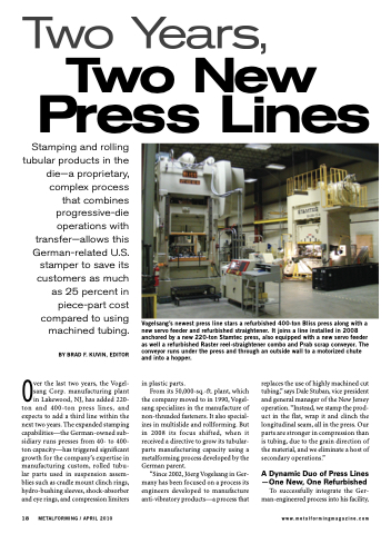

Over the last two years, the Vogel- sang Corp. manufacturing plant in Lakewood, NJ, has added 220- ton and 400-ton press lines, and expects to add a third line within the next two years. The expanded stamping capabilities—the German-owned sub- sidiary runs presses from 40- to 400- ton capacity—has triggered significant growth for the company’s expertise in manufacturing custom, rolled tubu- lar parts used in suspension assem- blies such as cradle mount clinch rings, hydro-bushing sleeves, shock-absorber and eye rings, and compression limiters
Vogelsang’s newest press line stars a refurbished 400-ton Bliss press along with a new servo feeder and refurbished straightener. It joins a line installed in 2008 anchored by a new 220-ton Stamtec press, also equipped with a new servo feeder as well a refurbished Raster reel-straightener combo and Prab scrap conveyor. The conveyor runs under the press and through an outside wall to a motorized chute and into a hopper.
