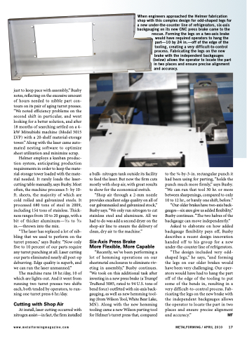

Asked to elaborate on how added backgauge flexibility pays off, Busby describes a recent design innovation handed off to his group for a new under-the-counter line of refrigerators.
“The design included very odd- shaped legs,” he says, “and forming the legs on our older brakes would have been very challenging. Our oper- ators would have had to hang the part off of the edge of the tooling to put some of the bends in, resulting in a very difficult-to-control process. Fab- ricating the legs on the new brake with the independent backgauges allows the operator to locate the part in two places and ensure precise alignment and accuracy.” MF

When engineers approached the Helmer fabrication shop with this complex design for odd-shaped legs for a new under-the-counter line of refrigerators, six-axis backgauging on its new CNC press brake came to the
rescue. Forming the legs on a two-axis brake would have required operators to hang the part—10 by 24 in.—off of the edge of the tooling, creating a very difficult-to-control
process. Fabricating the legs on the new
brake with the independent backgauges (below) allows the operator to locate the part
