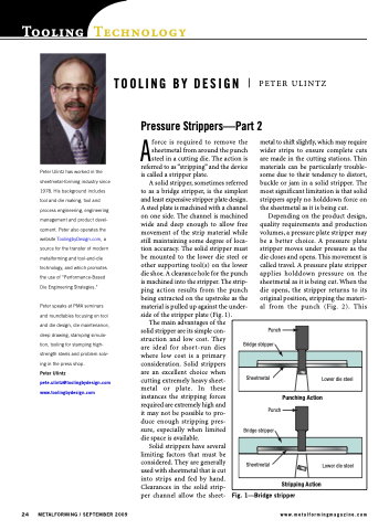

Aforce is required to remove the sheetmetal from around the punch steel in a cutting die. The action is referred to as “stripping” and the device is called a stripper plate.
A solid stripper, sometimes referred to as a bridge stripper, is the simplest and least expensive stripper plate design. A steel plate is machined with a channel on one side. The channel is machined wide and deep enough to allow free movement of the strip material while still maintaining some degree of loca- tion accuracy. The solid stripper must be mounted to the lower die steel or other supporting tool(s) on the lower die shoe. A clearance hole for the punch is machined into the stripper. The strip- ping action results from the punch being extracted on the upstroke as the material is pulled up against the under- side of the stripper plate (Fig. 1).
The main advantages of the solid stripper are its simple con- struction and low cost. They are ideal for short-run dies where low cost is a primary consideration. Solid strippers are an excellent choice when cutting extremely heavy sheet- metal or plate. In these instances the stripping forces required are extremely high and it may not be possible to pro- duce enough stripping pres- sure, especially when limited die space is available.
Solid strippers have several limiting factors that must be considered. They are generally used with sheetmetal that is cut into strips and fed by hand. Clearances in the solid strip- per channel allow the sheet-

metal to shift slightly, which may require wider strips to ensure complete cuts are made in the cutting stations. Thin materials can be particularly trouble- some due to their tendency to distort, buckle or jam in a solid stripper. The most significant limitation is that solid strippers apply no holddown force on the sheetmetal as it is being cut.
Depending on the product design, quality requirements and production volumes, a pressure plate stripper may be a better choice. A pressure plate stripper moves under pressure as the die closes and opens. This movement is called travel. A pressure plate stripper applies holddown pressure on the sheetmetal as it is being cut. When the die opens, the stripper returns to its original position, stripping the materi- al from the punch (Fig. 2). This
   Punch Bridge stripper
Punch
Bridge stripper
Punching Action
           Sheetmetal
          Sheetmetal
  Lower die steel
 Stripping Action
Lower die steel

Fig. 1—Bridge stripper
