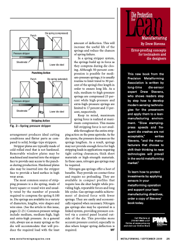

                            Pressure stripper
     Sheetmetal
Lower die steel
     Pressure stripper
   Sheetmetal
Lower die steel
   Die spring (compressed)
 Punch
    Punching Action

Punch
Die spring (extended)
      Stripping Action
Fig. 2—Spring pressure stripper
arrangement produces ideal cutting conditions and flatter parts as com- pared to solid, bridge-type strippers.
