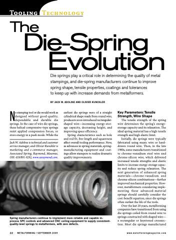

  Spring manufacturers continue to implement more reliable and capable in- process SPC controls and advanced CNC coiling equipment to supply consistent- quality-level springs to metalformers, with zero defects.
