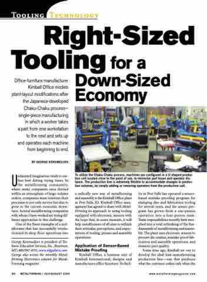

 Office-furniture manufacturer Kimball Office models plant-layout modifications after the Japanese-developed Chaku-Chaku process— single-piece manufacturing in which a worker takes a part from one workstation to the next and sets up and operates each machine from beginning to end.

 To utilize the Chaku-Chaku process, machines are configured in a U-shaped produc- tion cell located close to the point of use, to minimize part travel and operator dis- tance. The production line is extremely flexible to accommodate changes in produc- tion volumes, by simply adding or removing operators from the production cell.
