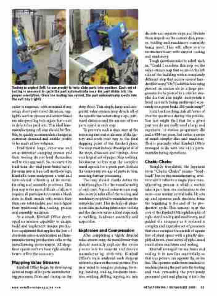

  Tooling is angled (left) to use gravity to help slide parts into position. Each set of tooling is sensored to cycle the part automatically once the part slides into the proper orientation. Once the tooling has cycled, the part automatically ejects into the exit tray (right).
