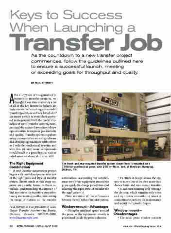

The front- and rear-mounted transfer system shown here is mounted on a 1500-ton mechanical press, with 256 by 96-in. bed, at Metrican Stamping, Dickson, TN.
