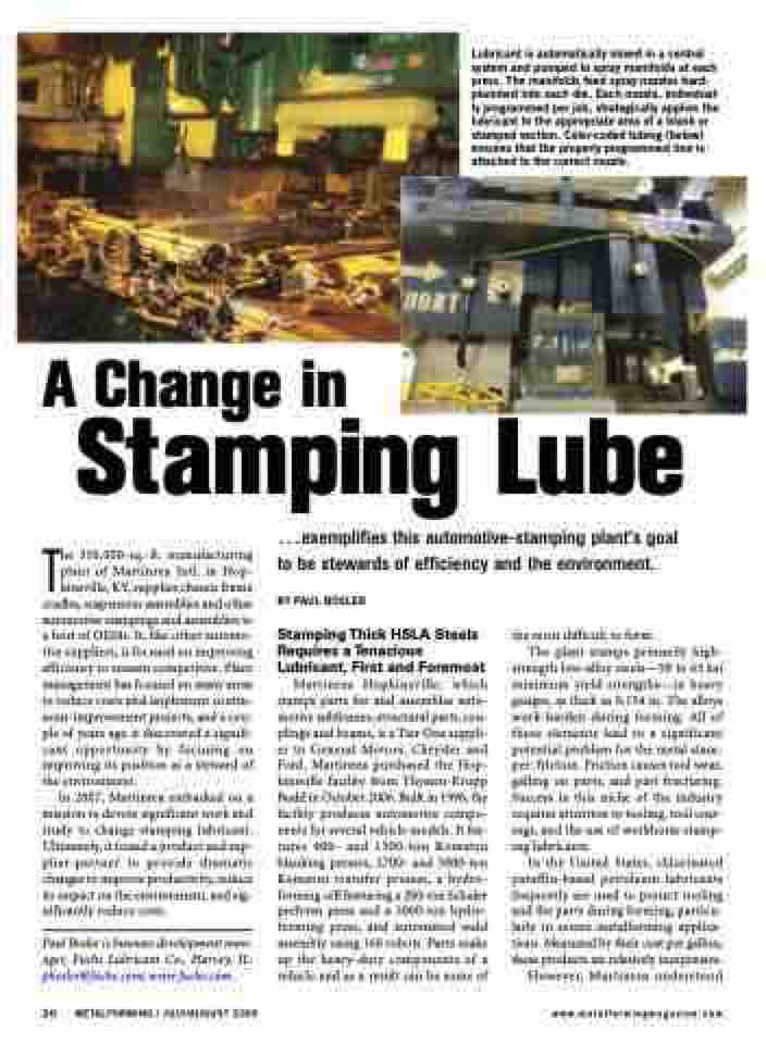

Lubricant is automatically mixed in a central system and pumped to spray manifolds at each press. The manifolds feed spray nozzles hard- plumbed into each die. Each nozzle, individual- ly programmed per job, strategically applies the lubricant to the appropriate area of a blank or stamped section. Color-coded tubing (below) ensures that the properly programmed line is attached to the correct nozzle.
