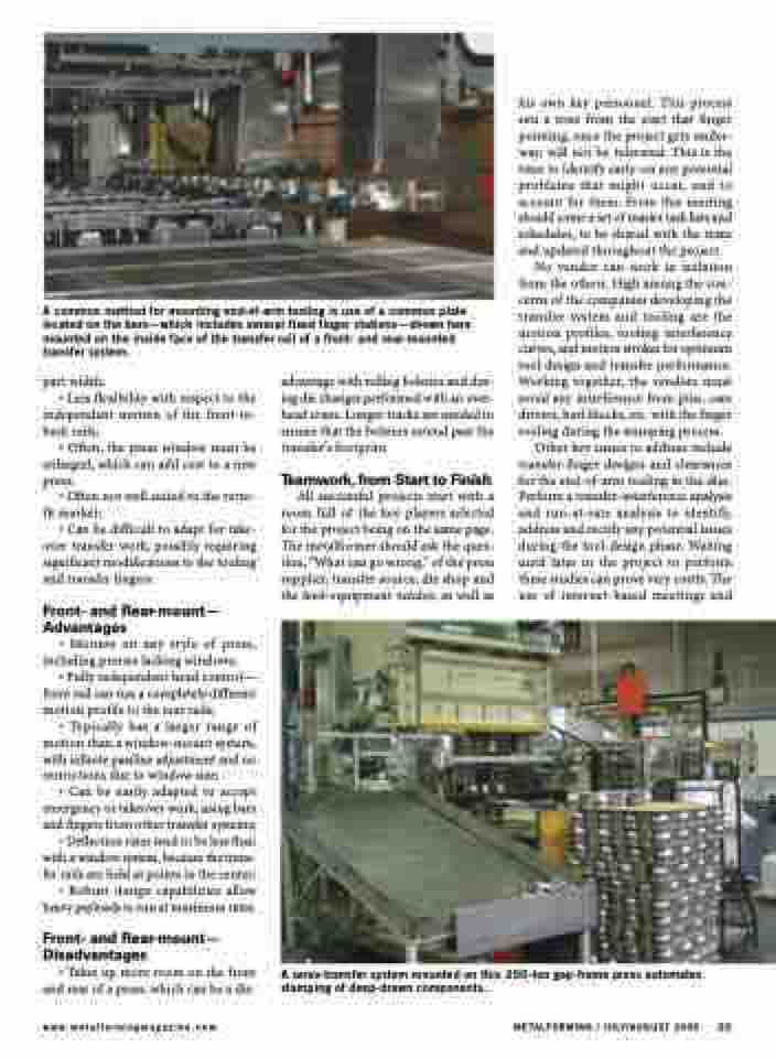

 A common method for mounting end-of-arm tooling is use of a common plate located on the bars—which includes several fixed finger stations—shown here mounted on the inside face of the transfer rail of a front- and rear-mounted transfer system.

A servo-transfer system mounted on this 250-ton gap-frame press automates stamping of deep-drawn components.
