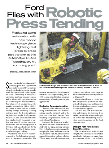

Ford replaced straight-path automation on Line 8 at Woodhaven with R-2000 six- axis robots located between presses. Production capacity doubled as a result.

“Although the lines were produc- tive, there was some downtime associ- ated with the aging robots,” explains Peter H. Stephan, program manager for stamping for Fanuc Robotics America, Inc., Rochester Hills, MI, which supplied much of the original and new robotics. “There was a general consensus that
replacing the robots could improve productivity on these lines by as much as 20 percent.”
Line 8 at Woodhaven, a 120-in. tan- dem setup fronted by a 1000-ton dual- action Danly draw press and backed by four 800-ton Danly presses, was part of that automation upgrade.
“On that line, with its old automa- tion and frequent breakdowns, if we yielded 200 parts/hr. we were walking in tall cotton,” says Randy Dively, an elec- trical controls engineer at the Ford stamping plant.
