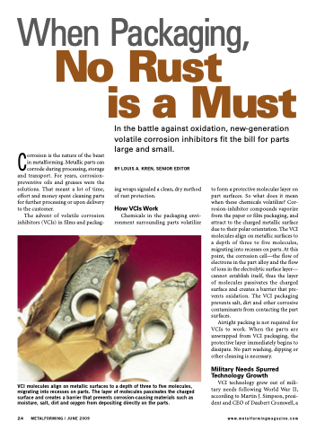

 VCI molecules align on metallic surfaces to a depth of three to five molecules, migrating into recesses on parts. The layer of molecules passivates the charged surface and creates a barrier that prevents corrosion-causing materials such as moisture, salt, dirt and oxygen from depositing directly on the parts.
