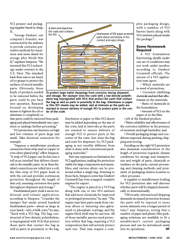

   A plain poly bag lines the crate and contains the VCI.
Interleaves of VCI paper protects parts above and below, in the contact and vapor phase.

To protect large metal stampings from corrosion during shipment and storage, the stamper lines the crate with a low-density polyeth- ylene bag impregnated with VCIs that protect the parts that contact the bag as well as parts in proximity to the bag. Interleaves or paper or film VCI sheets may be added, laid at intervals as the parts are stacked to ensure delivery of enough VCI to protect parts in the cen- ter of the crate.
