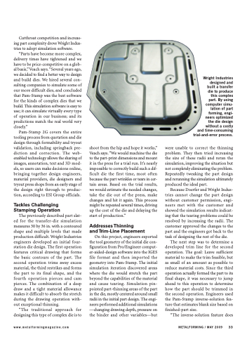

Cutthroat competition and increas- ing part complexity drove Wright Indus- tries to adopt simulation software.

On this project, engineers exported the tool geometry of the initial die con- figuration from Pro/Engineer comput- er-aided-design software into the IGES file format and then imported the geometry into Pam-Stamp. The initial simulation iteration discovered areas where the die would stretch the part beyond the capabilities of the material and cause tearing. Simulation pin- pointed part-thinning areas of the part in the die, mostly centered around small radii in the initial part design. The engi- neers performed additional simulations —changing drawing depth, pressure on the binder and other variables—but
Wright Industries designed and built a transfer die to produce this complex part. By using computer simu- lation of part forming, engi- neers optimized the die design without a costly and time-consuming trial-and-error process.
were unable to correct the thinning problem. They then tried increasing the size of these radii and reran the simulation, improving the situation but not completely eliminating the problem. Repeatedly tweaking the part design and rerunning the simulation ultimately produced the ideal part.
Because Doerfer and Wright Indus- tries cannot change the part design without customer permission, engi- neers met with the customer and showed the simulation results indicat- ing that the tearing problems could be resolved by increasing the radii. The customer approved the changes to the part and the engineers got back to the task of designing the rest of the die.
The next step was to determine a developed trim line for the second operation. The goal: Leave sufficient material to make the trim feasible, but as small of an amount as possible to reduce material costs. Since the third operation actually formed the part to its final shape, it was necessary to jump ahead to this operation to determine how the part should be trimmed in the second operation. Engineers used the Pam-Stamp inverse-solution fea- ture that estimates blank size based on finished-part size.
