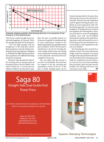

   Schematic showing properties of hot-forming steel from 1) as-received to 2) hot forming to 3) final quenched part.

220 ksi min. tensile strength and a typ- ical total elongation of 5 percent. This is the strength specified for the final part.
• The very high strength and low elongations of the final part restrict final operations to special cutting, trim- ming and piercing equipment designed to withstand the high loads generated by these operations. No additional forming should be attempted.
The above steps describe the “direct” hot-forming process during which all forming is done on the hot blank in the water-cooled die. A second process, called an “indirect” process, also is used.
Here the part is partially formed (to 90 percent complete) in traditional dies at room temperature. Instead of the blank being heated, the partially formed part is heated to 1650 F. The hot part is transferred to the die for forming the severe design features that tear during room-temperature forming. Quenching to the martensitic-steel microstructure completes the process.
One can argue that the process is too slow to be profitable. The total time for transfer to the die, forming and quenching is about 20-30 sec. If the part is small, multiple parts can be
