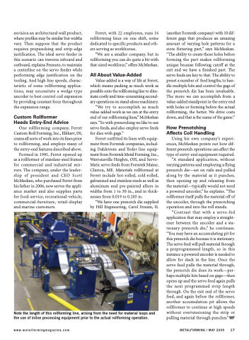

“A standard application, without varying patterns and employing a flying prenotch die—set on rails and pulled along by the material as it punches, then opening up and releasing from the material—typically would not need a powered uncoiler,” he explains. “The rollformer itself pulls the material off of the uncoiler, through the prenotching operation and into the roll stands.
“Contrast that with a servo-fed application that may employ a straight- ener between the uncoiler and a sta- tionary prenotch die,” he continues. “You may have an accumulating pit for this prenotch die because it is stationary. The servo feed will pull material through a preprogrammed length, so in this instance a powered uncoiler is needed to allow for slack in the line. Once the servo feed pulls the material through, the prenotch die does its work—per- haps multiple hits based on gags—then opens up and the servo feed again pulls the next programmed strip length through. On the exit end of the servo feed, and again before the rollformer, another accumulation pit allows the rollformer to continue at high speeds without overtensioning the strip or pulling material through punches.”MF
 Note the length of this rollforming line, arising from the need for material loops and the use of inline processing equipment prior to the actual rollforming operation.
