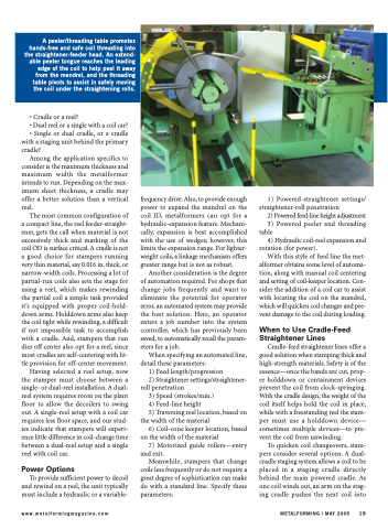

 A peeler/threading table promotes hands-free and safe coil threading into the straightener-feeder head. An extend- able peeler tongue reaches the leading edge of the coil to help peel it away from the mandrel, and the threading table pivots to assist in safely moving the coil under the straightening rolls.
