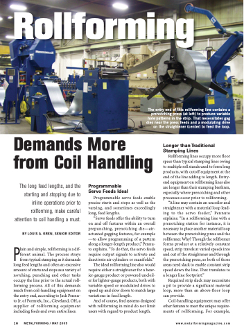

The entry end of this rollforming line contains a prenotching press (at left) to produce variable hole patterns in the strip. That necessitates gag dies near the press feeds and a modulating drive on the straightener (center) to feed the loop.
Demands More from Coil Handling

Rollforming lines occupy more floor space than typical stamping lines owing to multiple roll stands used to form long products, with cutoff equipment at the end of the line adding to length. Entry- end equipment on rollforming lines also are longer than their stamping brethren, especially where prenotching and other processes occur prior to rollforming.
“A line may contain an uncoiler and straightener with a material loop lead- ing to the servo feeder,” Pennuto explains. “In a rollforming line with a prenotching station for instance, it is necessary to place another material loop between the prenotching press and the rollformer. Why? Though the rollformer forms product at a relatively constant speed, strip travels at varied speeds into and out of the straightener and through the prenotching press, so both of those areas need slack to enable constant strip speed down the line. That translates to a longer line footprint.”
Required strip slack may necessitate a pit to provide a significant material loop, more than an above-floor loop can provide.
