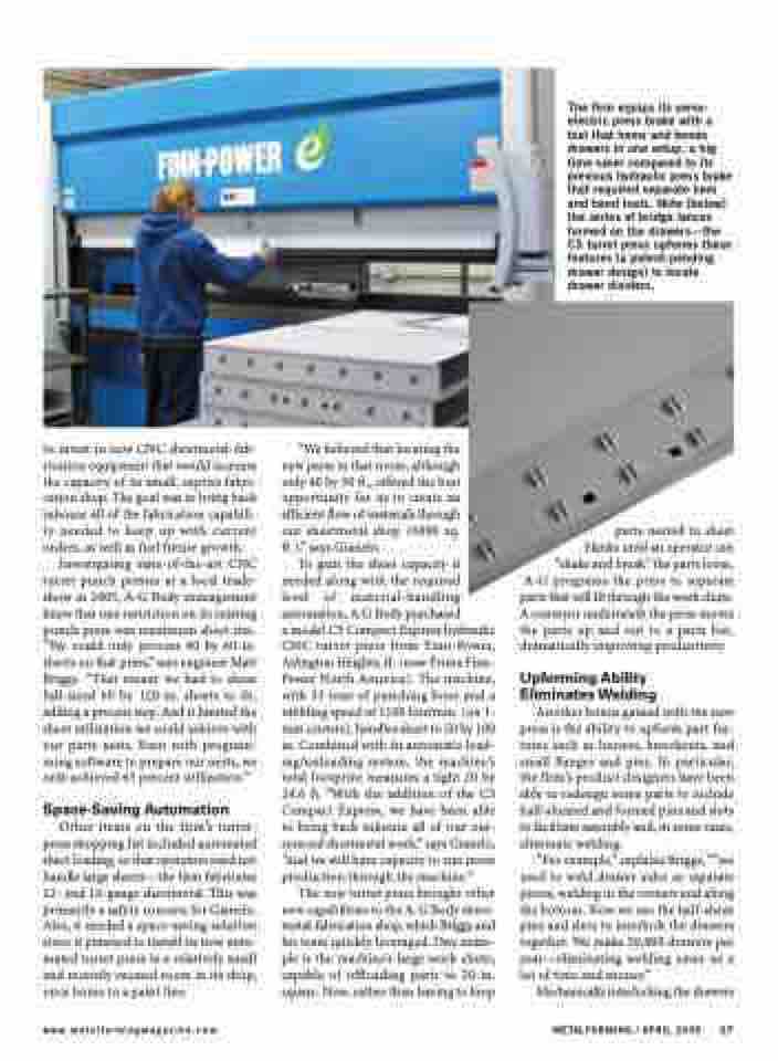

The firm equips its servo- electric press brake with a tool that hems and bends drawers in one setup, a big time saver compared to its previous hydraulic press brake that required separate hem and bend tools. Note (below) the series of bridge lances formed on the drawers—the C5 turret press upforms these features (a patent-pending drawer design) to locate drawer dividers.
