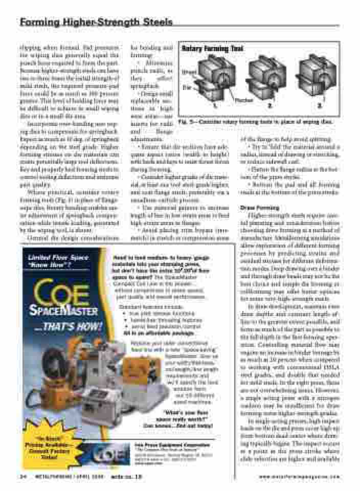

slipping when formed. Pad pressures for wiping dies generally equal the punch force required to form the part. Because higher-strength steels can have two to three times the initial strength of mild steels, the required pressure-pad force could be as much as 300 percent greater. This level of holding force may be difficult to achieve in small wiping dies or in a small die area.
Incorporate over-bending into wip- ing dies to compensate for springback. Expect as much as 10 deg. of springback depending on the steel grade. Higher forming stresses on die materials can create potentially large tool deflections. Key and properly heel forming steels to control tooling deflections and maintain part quality.
Where practical, consider rotary forming tools (Fig. 5) in place of flange- wipe dies. Rotary bending enables eas- ier adjustment of springback compen- sation while tensile loading, generated by the wiping tool, is absent.

Fig. 5—Consider rotary forming tools in place of wiping dies.
