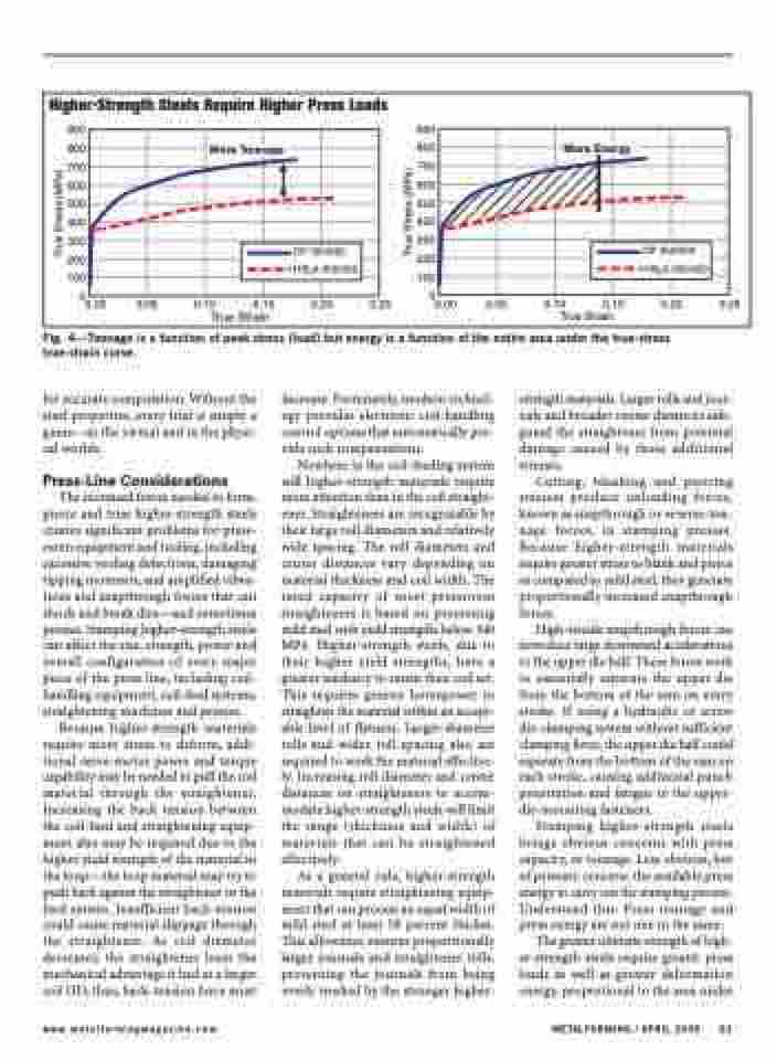

  Higher-Strength Steels Require Higher Press Loads
900 900 800 800 700 700 600 600 500 500 400 400 300 300 200 200 100 100
00.00 0.05 0.10 0.15 0.20 0.25 00.00 0.05 0.10 0.15 0.20 0.25 True Strain True Strain
 More Energy
DP 35
0/600
HSLA
350/450
  More Tonnage
   DP 35
0/600
HSLA
350/450
     Fig. 4—Tonnage is a function of peak stress (load) but energy is a function of the entire area under the true-stress true-strain curve.

Stamping higher-strength steels brings obvious concerns with press capacity, or tonnage. Less obvious, but of primary concern: the available press energy to carry out the stamping process. Understand this: Press tonnage and press energy are not one in the same.
The greater ultimate strength of high- er-strength steels require greater press loads as well as greater deformation energy, proportional to the area under
