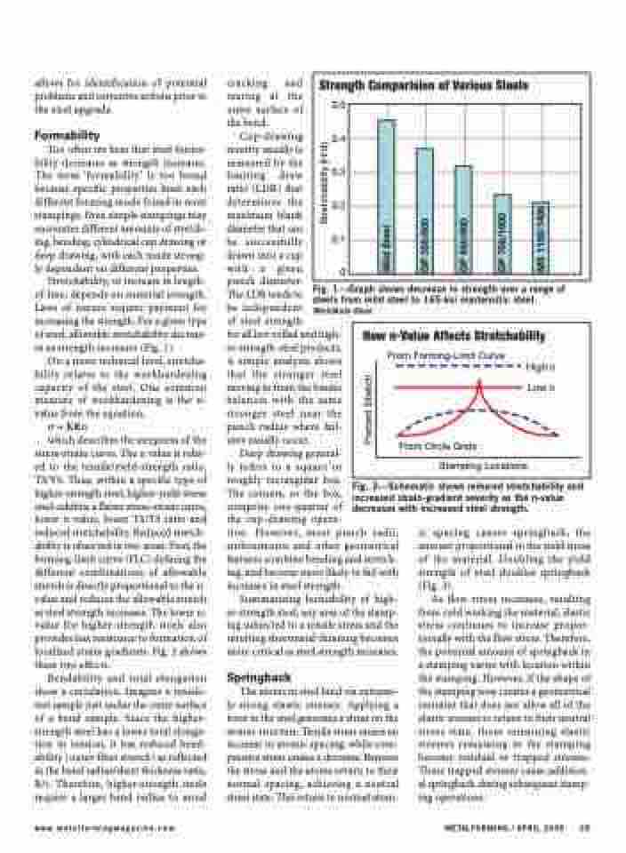

   Strength Comparision of Various Steels

Formability
Too often we hear that steel forma- bility decreases as strength increases. The term ‘formability’ is too broad because specific properties limit each different forming mode found in most stampings. Even simple stampings may encounter different amounts of stretch- ing, bending, cylindrical cup drawing or deep drawing, with each mode strong- ly dependent on different properties.
Stretchability, or increase in length- of-line, depends on material strength. Laws of nature require payment for increasing the strength. For a given type of steel, allowable stretchability decreas- es as strength increases (Fig. 1).
On a more technical level, stretcha- bility relates to the workhardening capacity of the steel. One common measure of workhardening is the n- value from the equation,
σ = Κ􏰀n
which describes the steepness of the stress-strain curve. The n value is relat- ed to the tensile/yield-strength ratio, TS/YS. Thus, within a specific type of higher-strength steel, higher-yield-stress steel exhibits a flatter stress-strain curve, lower n-value, lower TS/YS ratio and reduced stretchability. Reduced stretch- ability is observed in two areas. First, the forming-limit curve (FLC) defining the different combinations of allowable stretch is directly proportional to the n- value and reduces the allowable stretch as steel strength increases. The lower n- value for higher-strength steels also provides less resistance to formation of localized strain gradients. Fig. 2 shows these two effects.
Bendability and total elongation show a correlation. Imagine a tensile- test sample just under the outer surface of a bend sample. Since the higher- strength steel has a lower total elonga- tion in tension, it has reduced bend- ability (outer-fiber stretch) as reflected in the bend radius/sheet thickness ratio, R/t. Therefore, higher-strength steels require a larger bend radius to avoid
cracking and tearing at the outer surface of the bend.

Fig. 1—Graph shows decrease in strength over a range of steels from mild steel to 165-ksi martensitic steel. WorldAuto-Steel
  How n-Value Affects Stretchability
From Forming-Limit Curve
High n Low n
From Circle Grids
Stamping Locations
METALFORMING / APRIL 2009 19
Fig. 2—Schematic shows reduced stretchability and increased strain-gradient severity as the n-value decreases with increased steel strength.
ic spacing causes springback, the amount proportional to the yield stress of the material. Doubling the yield strength of steel doubles springback (Fig. 3).
