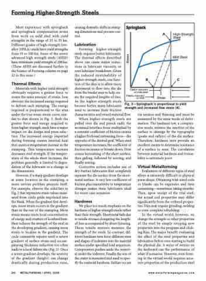

Forming Higher-Strength Steels
   Springback
  A High-Strength Steel
Mild Steel
   BC
Elastic recovery of mild steel
Elastic recovery
of HSS Strain
         Most experience with springback and springback compensation arises from work on mild steel with yield strengths in the range of 25 to 35 ksi. Different grades of high-strength low- alloy (HSLA) steels have yield strengths from 35 to 100 ksi. Some of the newer advanced high-strength steels (AHSS) have minimum yield strength of 200 ksi. (These AHSS are discussed further in the Science of Forming column on page 32 in this issue.)
Thermal Effects
Materials with higher yield strength obviously requires a greater force to create the same amount of strain. Less obvious: the increased energy required to deform each stamping. The energy required is proportional to the area under the true stress-strain curve, sim- ilar to that shown in Fig. 3. Both the greater force and energy required to form higher-strength steels have a major impact on die design and press selec- tion. The increased energy imparted during forming creates internal heat that causes a temperature increase in the stamping. This temperature increase decreases steel strength. If the temper- ature of the whole sheet increases, the problem generally is limited to degra- dation of the lubricant or a change in die dimensions.
However, if a sharp gradient develops at some location in the stamping, a more serious problem presents itself. For example, observe the solid line in Fig. 2 that represents strain values meas- ured from circle grids imprinted into the blank. When the gradient first devel- ops, more strain occurs in the gradient than in the rest of the stamping. More strain means more local concentration of energy and creation of localized heat. Heat reduces the strength of the steel in the developing gradient, causing more strain to localize in the gradient. The cycle constantly repeats until a severe gradient of surface strain and accom- panying thickness reduction too often leads to a local failure site (Fig. 2). Once a severe gradient develops, the severity of the gradient (height) can change drastically during production runs,
causing dramatic shifts in stamp- ing dimensions and process con- trol.

Fig. 3—Springback is proportional to yield strength and increased flow stress (A).
via tension and thinning and must be measured by the same mode of defor- mation. The hardness test, a compres- sive mode, mimics the reaction of the surface to damage by the typography (peaks and valleys) of the die surface. Therefore, hardness tests provide an excellent means to determine resistance of a surface to wear. The correlation between material hardness and forma- bility is extremely poor.
