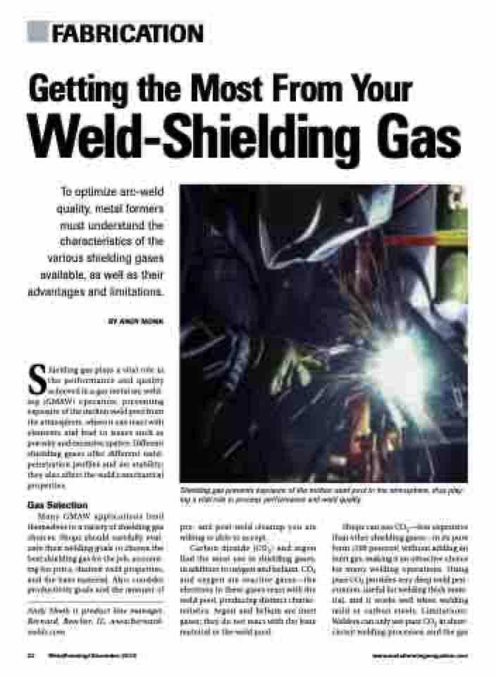

Shielding gas plays a vital role in the performance and quality achieved in a gas metal arc weld- ing (GMAW) operation, preventing exposure of the molten weld pool from the atmosphere, where it can react with elements and lead to issues such as porosity and excessive spatter. Different shielding gases offer different weld- penetration profiles and arc stability; they also affect the weld’s mechanical properties.

Shielding gas prevents exposure of the molten weld pool to the atmosphere, thus play- ing a vital role in process performance and weld quality.
