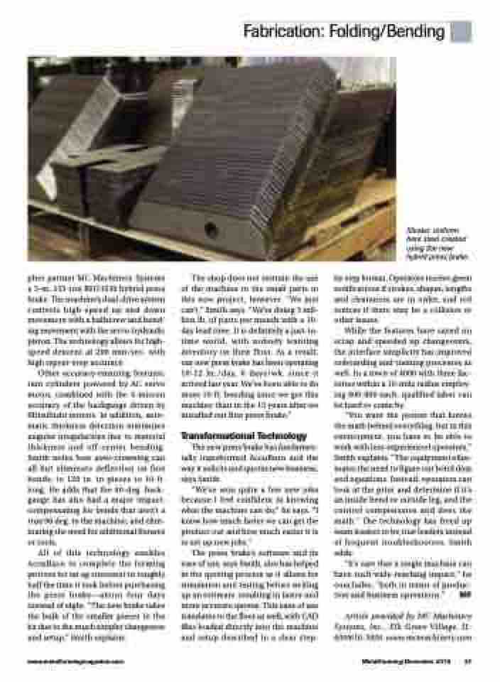

Shown: uniform bent steel created using the new hybrid press brake.
