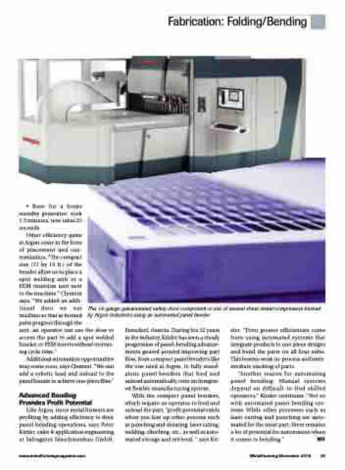

This 14-gauge galvannealed safety-door component is one of several sheet metal components formed by Argon Industries using an automated panel bender.
