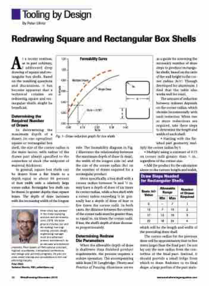

Formability Curve
Multiple Draws
Single Draw
Rc/w = 0.067
0.10 0.20 0.30 Rc/w
Rc
w
   0.00
0.40
h

Fig. 1—Draw reduction graph for box shells
side. The formability diagram in Fig. 1 illustrates the relationship between the maximum depth of draw (h-max), the width of the longest side (w) and the size of the corner radius (Rc) on the number of draws required for a rectangular product.
More specifically, a box shell with a corner radius between 3⁄8 and 1⁄2 in. may have a depth of draw of six times its corner radius, while a box shell with a corner radius exceeding 1⁄2 in. gen- erally has a depth of draw of four to five times the corner radii. In both cases, the distance between the centers of the corner radii must be greater than, or equal to, six times the corner radii. If less, the shell’s depth of draw decreas- es proportionately.
