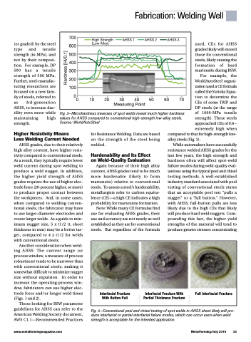

Hardenability and Its Effect on Weld-Quality Evaluation
Again because of their high alloy content, AHSS grades tend to be much more hardenable (likely to form martensite) relative to conventional steels. To assess a steel’s hardenability, metallurgists refer to carbon equiva- lence (CE)—a high CE indicates a high probability for martensite formation.
Note: While many CE formulas find use for evaluating AHSS grades, their use and accuracy are not nearly as well established as they are for conventional steels. But regardless of the formula
compared to that for high-strength low- alloy steels (Fig. 3).
While automakers have successfully resistance welded AHSS grades for the last few years, the high strength and hardness often will affect spot-weld failure modes during weld-quality eval- uations using the typical peel and chisel testing methods. A well-established industry standard associated with peel testing of conventional steels states that an acceptable peel test “pulls a nugget” or a “full button.” However, with AHSS, full-button pulls are less likely due to the high CEs that likely will produce hard weld nuggets. Com- pounding this fact, the higher yield strengths of the material will tend to produce greater stresses concentrating

Fig. 3—Microhardness traverses of spot welds reveal much higher hardness values for AHSS compared to conventional high-strength low-alloy steels. Source: WorldAutoSteel
used, CEs for AHSS grades likely will exceed those for conventional steels, likely causing the formation of hard martensite during RSW.
For example, the WorldAutoSteel organi- zation used a CE formula called the Yurioka Equa- tion to determine the CEs of some TRIP and DP steels (in the range of 1000-MPa tensile strength). These steels approached CEs of 0.6 – extremely high when
 Interfacial Fracture Interfacial Fracture With Full Interfacial Fracture With Button Pull Partial Thickness Fracture

Fig. 4—Conventional peel and chisel testing of spot welds in AHSS sheet likely will pro- duce interfacial or partial interfacial failure modes, which can occur even when weld strength is acceptable for the intended application.
