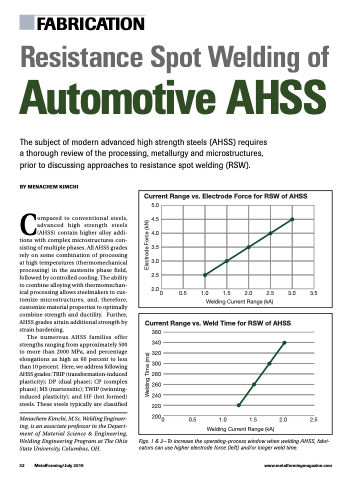

Figs. 1 & 2—To increase the operating-process window when welding AHSS, fabri- cators can use higher electrode force (left) and/or longer weld time.
  Current Range vs. Electrode Force for RSW of AHSS
5.0 4.5 4.0 3.5 3.0 2.5 2.0
0 0.5
1.0 1.5 2.0 2.5 Welding Current Range (kA)
3.0 3.5
                                             Current Range vs. Weld Time for RSW of AHSS
360 340 320 300 280 260 240 220 200 0
                 0.5 1.0
1.5 2.0 2.5
 32 MetalForming/July 2019
Welding Time (ms) Electrode Force (kN)
