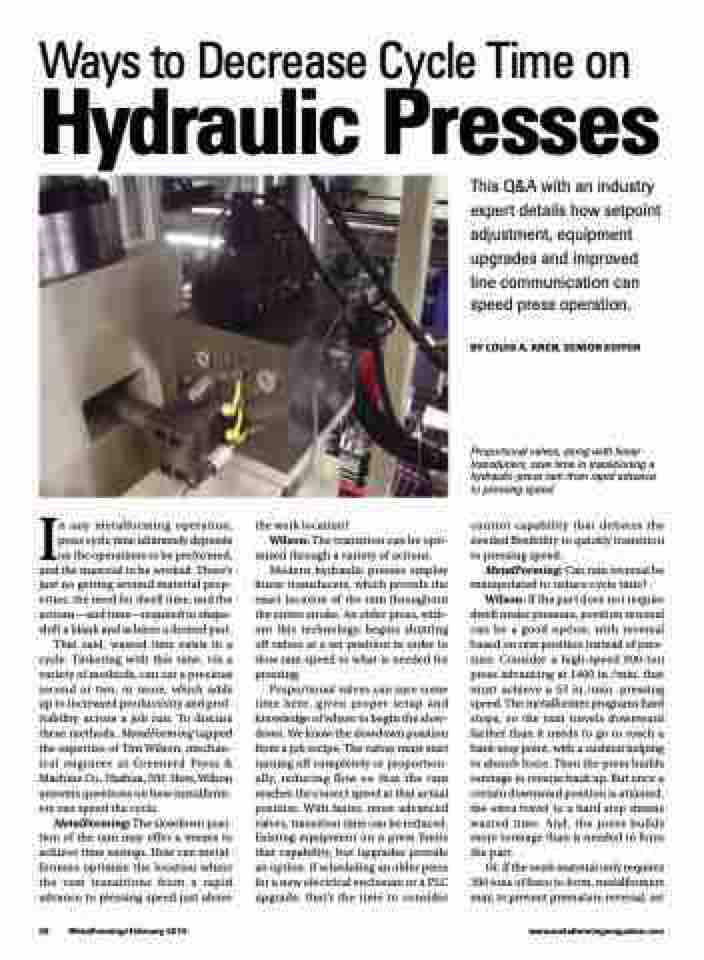

Proportional valves can save some
time here, given proper setup and knowledge of where to begin the slow- down. We know the slowdown position from a job recipe. The valves must start turning off completely or proportion- ally, reducing flow so that the ram reaches the correct speed at that actual position. With faster, more advanced valves, transition time can be reduced. Existing equipment on a press limits that capability, but upgrades provide an option. If scheduling an older press for a new electrical enclosure or a PLC upgrade, that’s the time to consider
This Q&A with an industry expert details how setpoint adjustment, equipment upgrades and improved line communication can speed press operation.
Proportional valves, along with linear transducers, save time in transitioning a hydraulic-press ram from rapid advance to pressing speed.
control capability that delivers the needed flexibility to quickly transition to pressing speed.
