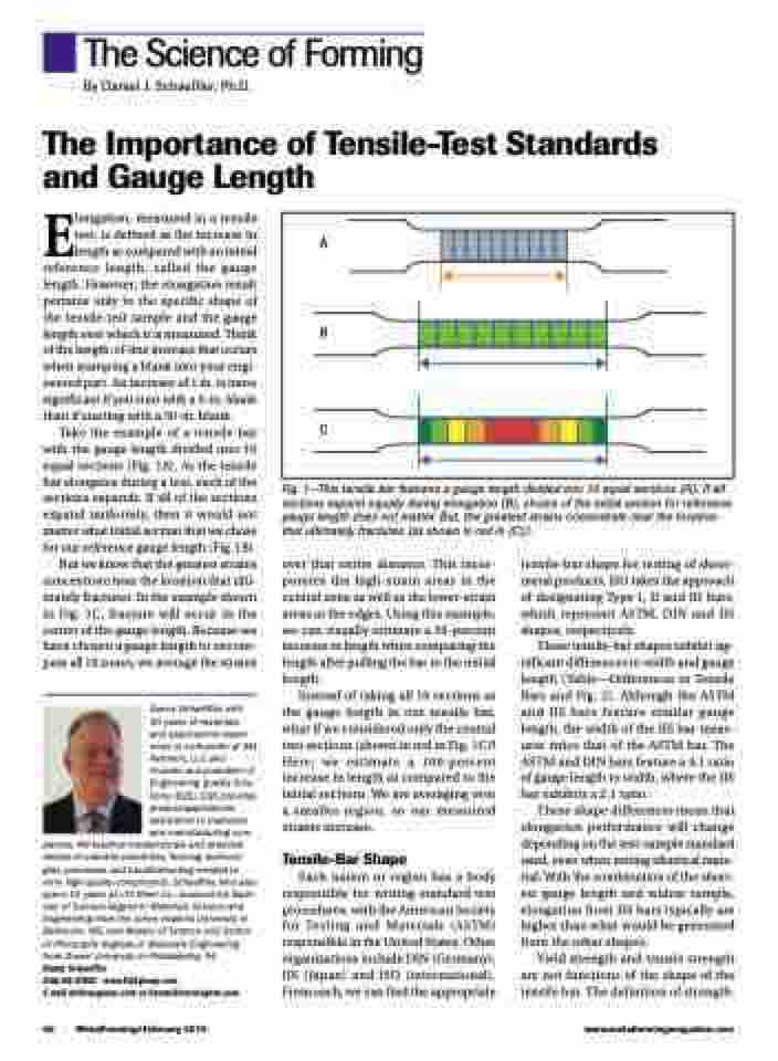

                                            Elongation, measured in a tensile test, is defined as the increase in length as compared with an initial reference length, called the gauge length. However, the elongation result pertains only to the specific shape of the tensile-test sample and the gauge length over which it is measured. Think of the length-of-line increase that occurs when stamping a blank into your engi- neered part. An increase of 1 in. is more significant if you start with a 5-in. blank than if starting with a 30-in. blank.
Take the example of a tensile bar with the gauge length divided into 10 equal sections (Fig. 1A). As the tensile bar elongates during a test, each of the sections expands. If all of the sections expand uniformly, then it would not matter what initial section that we chose for our reference gauge length (Fig. 1B).
But we know that the greatest strains concentrate near the location that ulti- mately fractures. In the example shown in Fig. 1C, fracture will occur in the center of the gauge length. Because we have chosen a gauge length to encom- pass all 10 zones, we average the strains

Fig. 1—This tensile bar features a gauge length divided into 10 equal sections (A). If all sections expand equally during elongation (B), choice of the initial section for reference gauge length does not matter. But, the greatest strains concentrate near the location that ultimately fractures (as shown in red in (C)).
over that entire distance. This incor- porates the high-strain areas in the central zone as well as the lower-strain areas at the edges. Using this example, we can visually estimate a 50-percent increase in length when comparing the length after pulling the bar to the initial length.
Instead of taking all 10 sections as the gauge length in our tensile bar, what if we considered only the central two sections (shown in red in Fig. 1C)? Here, we estimate a 100-percent increase in length as compared to the initial sections. We are averaging over a smaller region, so our measured strains increase.
