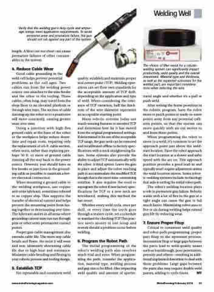

    Verify that the welding gun’s duty-cycle and amper- age ratings meet application requirements. To avoid excessive wear and premature failure, the gun should not rub against any part of the system.
