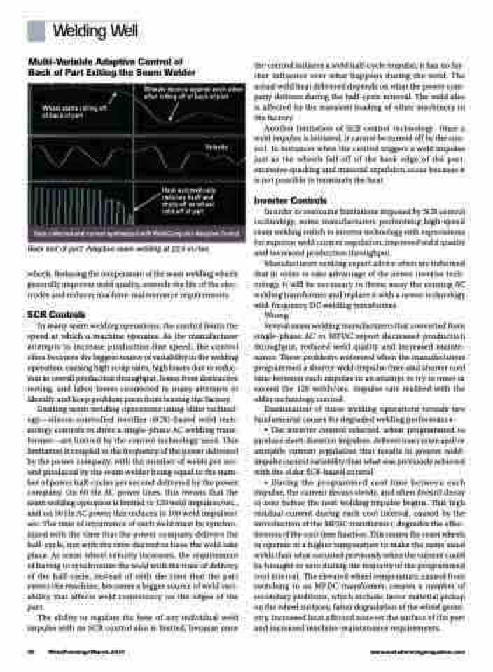

 Wheel starts rolling off of back of part
Wheels bounce against each other after rolling off of back of part
Velocity
Heat automatically reduces itself and shuts off as wheel rolls off of part
Data collected and current synthesized with WeldComputer Adaptive Control
Back end of part: Adaptive seam welding at 22.5 in./sec.
