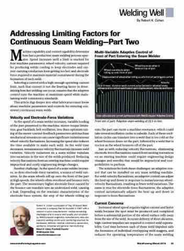

Another challenge: As the speed of a seam welder increas- es, so does electrode-force variation, a source of weld vari- ation. As the seam wheels roll up onto the front of the part at high speeds, the wheels often overshoot and bounce onto the part. The momentary higher electrode force caused by the bounce can translate into an undersized weld, causing a leak. Depending on the resonant characteristics of the electrode-force system, the step of the wheels rolling up

Multi-Variable Adaptive Control of Front of Part Entering the Seam Welder
 Wheel overshoots when rolling up onto front of part
Wheel bounces when it lands on top of part
Displacement of wheel when rolling up onto front of part triggers current
Velocity
Each 5-msec.-duration weld-current pulse (below) is adjusted every millisecond to control weld based upon displacement, velocity and force
Data collected and current synthesized with WeldComputer Adaptive Control
Front ent of part: Adaptive seam welding at 22.5 in./sec.
onto the part can excite a machine resonance, which could take several oscillation cycles to subside. Each of these oscil- lation cycles can translate into a weld that is too cold as the wheel bounces down on the part, followed by a weld that is too hot as the wheel bounces off of the part.
Just as with reducing velocity fluctuations, eliminating electrode-force fluctuations caused from exciting resonances on an existing machine could require engineering design changes and retrofits that would be impractical and cost- prohibitive to perform.
The solutions for both these challenges: an adaptive con- trol that can be installed on any seam welding machine. For weld-velocity fluctuations, an adaptive control can adjust the heat up and down in response to instantaneous wheel- velocity fluctuations, resulting in fewer weld variations. The same is true for electrode-force fluctuations; the adaptive control automatically adjusts the heat up and down in response to force fluctuations.
