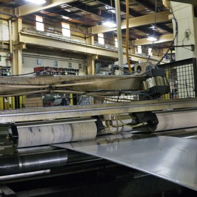

An Even, Thin Lube Layer, Top and Bottom
“The biggest benefit from the roller coater, compared to our spray systems on the other presses,” says Essenburg, “is the ability to apply lubricant evenly on the bottom as well as the top of the material. With the spray systems, to ensure consistent coverage across the entire sheet often requires overspraying. And, even then, we’re not always able to adequately coat the outer edges of the tooling with lube, where the stock may be dry and cause premature tool wear.”

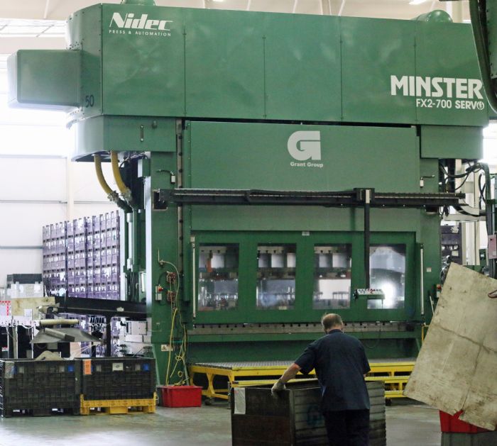

Since bringing in the new 700-ton servo press, in mid-2019, Grant has moved eight dies over from the 800-ton conventional mechanical press, “to allow us to reduce lubricant consumption and tool wear,” Essenburg says, “and also to run faster, taking advantage of the servo press’s pendulum motion profile.”
Compared to running tools on the conventional press equipped with spray-lubrication systems, Grant has experienced, on average, a 35-percent reduction in lubricant consumption, as well as a 30-percent increase in the number of hits between tool-maintenance cycles.
“Those two factors, in addition to less cleanup around the press since there’s no overspray,” adds Grant, “easily justified the investment in the roller coater. In fact, we’re evaluating investing in a second Unist system, for the 800-ton Nidec Minster press.

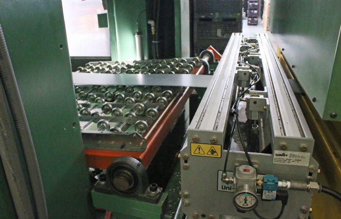

The roller coater continuous stock-lubrication system installed on Grant Industries’ new servo press features rollers—on the top and bottom of the stock—through which lubricant flows from the inside out. A dispenser tube inside each of each roller has small holes placed along its length through which fluid is injected, under precise control. Lubricant transfers to the stock on its way to the press via polyester-felt or polyurethane-foam roller covers. With the internally fed roller design, the roller coater may only need to inject lubricant into the rollers once every eight to 10 press strokes, just to keep the roller covers saturated in order to adequately coat the coil stock, compared to a spray system that may need to apply lube with every press stroke. |
The Unist SmartFlow controller that directs the roller coater alerts users, by monitoring sensor data, to issues before they become expensive problems, such as low fluid supply runs, out-of-tolerance fluid pressure, or if flow to one of the applicators becomes interrupted. The fluid-supply tank includes low- and high-level sensors, with a float switch to allow for automatic filling through the plant’s central lube system and two mixing tanks—one tank for a water-based “house lube,” and a second auxiliary tank to allow mixing of custom lubricants to customer specs. It can send error messages directly to the press-control HMI and enable the press operator to make any necessary adjustments to the lube system at the press control.
