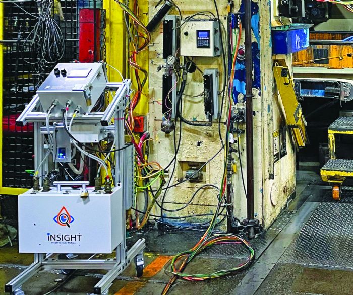

At Irmco’s disposal to bring such data collection to the Metalsa pressroom: its patented iNSight system, developed by Kenny and Irmco production and facility manager Steve Glowacz. It’s designed to track lubricant volume delivered per stroke; parts stamped per gallon; and, ultimately, lubricant cost per part. The system senses and sends alerts when production stops or when concentration or mixing changes beyond spec; identifies changes in process settings or variables from one shift to another; and allows shops to compare before-and-after modifications to processes to validate process-improvement activities.
To develop iNSight, Irmco modified a cart-mounted high-pressure lubricant-spray system (a Spra-Rite from Industrial Innovations), adding an electronics package for data logging as well as sensors to monitor flow, concentration and pressure. A cellphone modem enables the setup to send out data alerts.

irmco insight on 2500 ton press at metalsa“We had Irmco install the iNSight system on a 2500-ton coil-fed transfer press,” Struckmeyer shares, “outfitted with 24 manifold inputs—16 on the top die section and eight underneath. We used iNSight only for monitoring the top manifolds. We run two 10-ft. dies on that press and, depending on the part and process, will spray lubricant in the first die for blanking and the second die set for forming.”

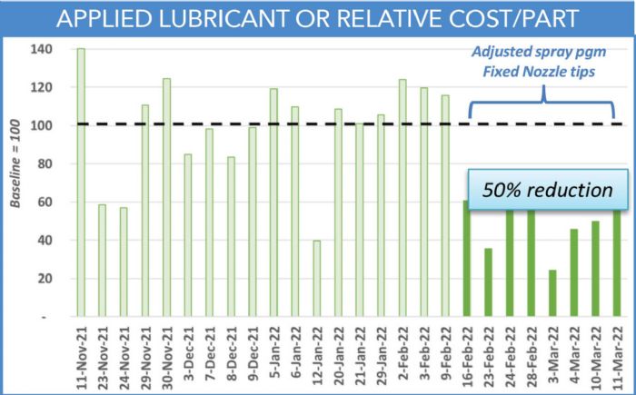

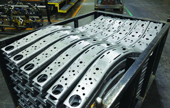

Kenny recalls the most significant discovery of the data-collection exercise: “We were able to show the Metalsa production team very interesting and actionable data on two big runners: left- and right-hand siderails, for which we had identified a significant difference in the amount of lubricant being applied for essentially the same part geometries.”
The Diagnosis
Metalsa siderailsReviewing the system health data collected, Kenny and the Metalsa team found that the spray program for one of the parts had been altered, considerably so, leading to an overspray situation. And, after analyzing the data, the production team, upon close investigation of the system components, found that some of the spray-nozzle tips either had been exchanged for larger sizes, or drilled out, presumably to cure clogs. The larger nozzle openings led to overspray.
“But our biggest discovery,” Kenny recalls, “was that some of the parts were being sprayed twice per stroke. Adjusting the process to eliminate the extra spray immediately cut lubricant consumption in half at that die station.”
By eliminating the double-spray and replacing all of the tips with smaller 8001-model tips, Metalsa realized an immediate savings of $20,000.
