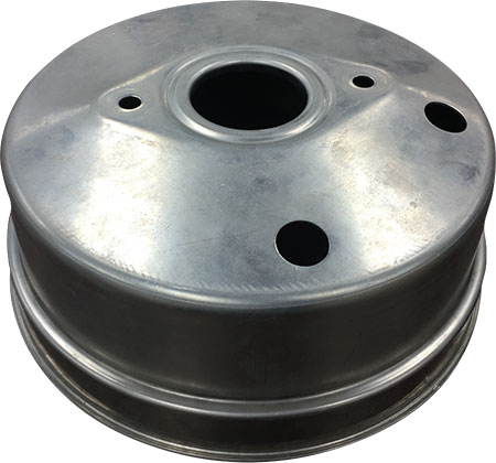

Whether a mineral- or renewable-resource oil-based lubricant, new chlorine-free soluble oils now are pushing the envelope on aluminum-stamping applications. As an example, consider that for several years, an automotive-parts supplier formed parts from 0.055-in.-thick Type 5754 aluminum, with a 4-in. draw depth, using a chlorinated-paraffin straight oil. By switching recently to a chlorine-free soluble oil, diluted 4:1 with water, the stamper eliminated sporadic tearing and galling while reducing lubricant use and cost. Furthermore, it eliminated all cleaning and application issues.
Automotive-parts suppliers that typically deep-draw aluminum (shown here) using a chlorinated-paraffin straight oil can switch to a chlorine-free soluble oil and eliminate tearing and galling concerns while reducing lubricant use and cost. |
